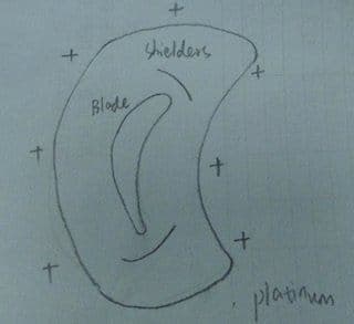

Q. Dear all
I am designing a conforming anode for platinum plating on industrial gas turbine blade, because extra platinum is built on the edges during plating due to its complex shape.
I am using the 5Q salt from Johson Matthey, maintaining a temperature of 92 °C, pH 10.5 and CD ranging from 0.4 - 0.6 A/dm2.
The anode material that I use is pure platinum wire gauze and I have two candidates.
See picture:
19693-3a  19693-3b
The first one is two gauzes which are bent to fit either side of the blade to make sure distance between anode and the blade is 1" to 1.5", and two shields made of teflon protect the edges from the current gathering.
Second one is a bigger circle around the blade and the distance is also 1"to 1.5".Shields to be put at the same position as the first one.
Any suggestions on which one is suitable? Or maybe none.
