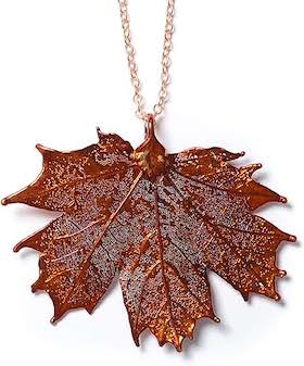

Q. I am getting an electroplating set up and want to start making electroplated leaves and such for jewelry. I am trying to research how to make the leaves iridescent after copper electroplating is done. I'm willing to purchase a book or take a class. I just can't find what best suits my need. Thanks. ⇦ Answer?

A. Lora, Kim,
Part of the problem I'm having in trying to figure out how to provide you advice is that I have no good frame of reference for what you want. Is there any chance you can provide us with some links or pictures to what you are trying to do?
One more additional note, this may be a patina, please take a look at:
www.ganoksin.com/borisat/nenam/iridescent-patina.htm
Blacksmith - Boone, North Carolina, USA

A. After taking a look at the pictures it does appear that finish is indeed the product of an oxidation reaction. The previous link I provided to the patina recipe should provide you a similar result.
Marc BanksBlacksmith - Boone, North Carolina, USA
A. Iridescence on copper metal can be very easily realized using H2S (hydrogen sulfide). You can obtain all the colours of the light spectrum with different times of contact between H2S gas and the copper metal.
