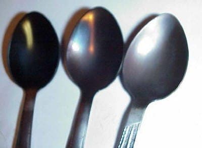

A. I can suggest black oxide finish. It is not highly durable, however covered with any acceptable clear lacquer can work.
The picture below shows samples from light grey to dark black (can be matte also).
black oxided stainless steel
