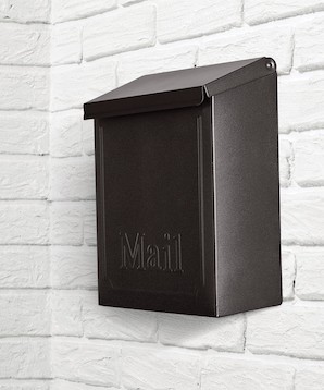

Q. Hello, just stumbled on your helpful site. Question: would your Copper Patina Repair Kit work for my scenario? The bathrooms in my house all have the black finish but unfortunately my well water has caused mineralization and a white coating to accumulate around the bases & stems on the fixtures. A Mr. Fix It guy recommended trying a lime & scale removal product (Lysol) but when I tried it, to my alarm it removed not only the scale & oxidation BUT THE BLACK COATING on the base of the fixtures, revealing what looks like copper. I'm horrified and wonder if I can re-finish these fixtures & how to remove lime & scale in the future w/o damaging the coating! Thanks - wish I had found this site earlier!
Dar Downingretired - Grass Valley, California
March 21, 2025
A. Hello Dar. Thanks for reaching out.
Yes, our Copper Patina Repair kit will restore an oil rubbed brown look all the way to black determined by the amount of heat you apply to the surface of the metal object pre and post application. Heat affects the darkness of the reaction on copper, brass and bronze. Feel free to contact us for direction and guidance. Also you can send pictures for consult to 760-846-3323.
