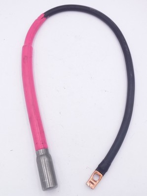

     To bring current to the parts inside the barrel, most, but not all, plating barrels use a pair of "danglers", i.e., heavy cables with knob on the end which dangle into the pile of parts in the barrel.

Barrel leads (danglers) break when plating long fasteners
Q. Dear sir,
When we plate long length fastener items like length M10x210 mm or M10x238 mm, barrel leads break during process and we have to face loss of time, and cost.
Is there any way to stop such type of problem?
Help me!
kapil_gupta
Kapil Gupta
tools - Faridabad, India
May 22, 2011
A. Dear Gupta,
Use a tight PVC sleeve over the solder Joining point (Dangler and the cable).
All the best.
