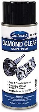

Eastwood Diamond Clear
A. I've been rusting many things for a clients house and I've found that Eastwood has a spray clear .
for restoring cars that works great. There are gloss and satin clears for painted and bare metals. One they have is supposed to stop rust, but be careful I think this one can get milky if put on uneven.
