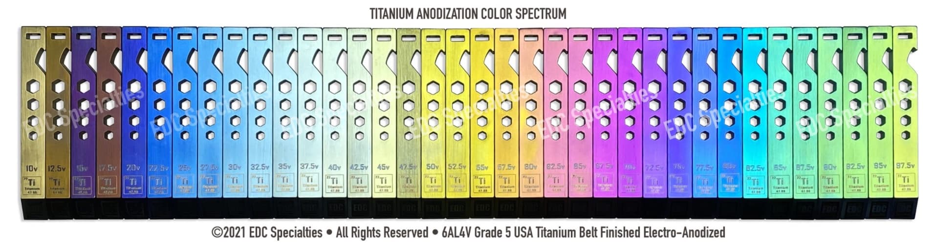

A. Search for "Titanium Anodization Color Spectrum" on your search engine of choice to find some great pictures that make the concept of first and second blue clear.
Some sites show approximate voltages to achieve each color - depending on tank make-up.
Speaking from experience, the colors on the EDC Specialties website line up pretty well with the results from using an anodize tank at around 300 g/l sulfuric acid.
(courtesy of EDC Specialties)
