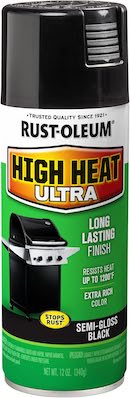

Q. I would also like to know the best way to spray paint shiny, brass, fireplace doors. It looks very dated in our living room. A magnet sticks - so if I'm correct, it must be brass coated steel? I was going to use Weber grill spray paint since it's heat resistant. Should I use heat resistant primer, too - which I'm not sure if they make. I plan on roughing up the surface with course steel wool ⇦ this on eBay or Amazon [affil links] , first. we do use the fireplace a lot so I need the paint to stay on.
Wendy Schollerhobbyist/artist - Milwaukee, Wisconsin

A. Hi, Lyndey, Wendy, Anne. A Self-etching primer ⇦ this on eBay or Amazon [affil links] made for metal, followed by high temperature paint should do well on brass. High temperature paint is not the equal of porcelain enameling, though, so I wouldn't guarantee everything will be fine, although I suspect it will in most cases. Good luck.
