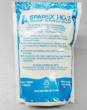

First, I'm assuming that I'm dealing with *two* different problems. The "blackened" deposit, which I assume to be carbon, and oxidized copper. The thought is that I now have to clean the copper with two or possibly three solutions.
The first would be the sulfuric acid solution (Sparex ⇦ on eBay or Amazon [affil link] ). This does a great job of removing the black. At room temperature, I've been leaving the pieces in that solution for a couple of days.
After rinsing with tap water, I'm torn how to proceed next. Based on information from this site, I tried two different cleaning solutions, lemon juice, then vinegar in bulk on eBay or Amazon [affil link] and salt solution. I don't have the benefit of time and experience to be able to know the difference. This is our livelihood and how quickly find solutions will have a big effect on our small (but ever-so-important) pocketbook.
Both solutions cleaned well, but the lemon juice took much longer than the distilled white vinegar and salt solution. That solution took less than 30 seconds to clean the sample parts. The biggest difference came when the parts came out of the solutions, or when I tried to "wipe-on" the solution.

A. There is one piece of critical information you have left out of your detailed description. What type of glue are you using? You might find that Sparex does a wonderful job of removing firescale. However, that may not help with glue adhesion if the surface to be glued (either the copper or the wood) has been contaminated with oils (possibly from handling the pieces). Have you tried wiping down the surface prior to gluing with alcohol or (better yet) acetone ⇦ on eBay or Amazon [affil link] Flammable! ? This may be a possible answer to your adhesion problem.
