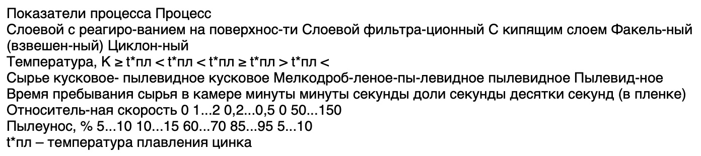

Hello! Dear gentlemen, I am glad that I accidentally came across your wonderful website. I have read the material with great interest. As a candidate of technical sciences, I have been engaged in the industrial technology of zinc oxide for a long time, through the processing of zinc-containing materials and pure metallic zinc. Since the French method is being discussed on your website, I would like to present to you the industrial method of processing in cyclone-type furnaces. I hope you find it interesting.
We have been engaged in the production of zinc oxide for many years, both from zinc-containing raw materials and from metallic zinc. Since only the French method is considered here, I will allow you to present only the experience regarding this method.
An analysis of possible options for organizing fire-technical processes -- layer-by-layer, when the gas phase interacts with the surface of the layer; layer-by-layer filtration; with a fluidized bed; flare /suspended/ and cyclone -- indicates that the most promising approach to solving this problem is the use of energy-technological cyclone units.
Comparison of the performance indicators of various technological processes.
| Layered with surface reaction | Layered filtration | Fluidized bed | Flame (suspended) | Cyclone | |
| Temperature, K | ≥ t*melting | < t*melting | < t*melting | ≥ t*melting | > t*melting |
| Raw material | Lumpy-powdered | Lumpy | Finely crushed-powdered | Powdered | Powdered |
| Residence time of raw material in the chamber | minutes | minutes | seconds | fractions of a second | tens of seconds (in the film) |
| Relative speed | 0 | 1...2 | 0.2...0.5 | 0 | 50...150 |
| Dust entrainment, % | 5...10 | 10...15 | 60...70 | 85...95 | 5...10 |
Studies of cyclone processing of various raw materials and on various horizontal and vertical cyclone units have confirmed that cyclone processing of raw materials always results in a multiple intensification of the technological process at very high specific heat loads in the working chamber. The specific productivity obtained for many processes, with far-reaching possibilities for further increase, is 2...4 t/m3h at heat loads of 5.5-103... 104 kW/m3, which is ten times higher than the loads achieved in existing firing and smelting devices. At the same time, cyclone processes are characterized by low heat consumption during the production process itself.
Thus, the available data indicate the great efficiency and prospects of cyclone plants. Designed and operating various modifications of cyclone plants for different types of raw materials: dusty and lump, showed high technical and economic performance. I will only cite here the basic cyclone pilot-industrial plant.
The furnace is a metal casing lined inside with refractory and thermal insulation material 4 and includes cyclone recovery chambers 3 with an inner diameter of 270 mm and a length of 1500 mm, and oxidation chambers 6 with an inner diameter of 350 mm. The furnace is equipped with three two-wire venturi-type burners; burner 2 is tangential, supplies a gas-air mixture, and is equipped with three nozzles 14 located in one plane at an angle of 120° relative to each other. The other burner 12 is the loading burner (only for zinc-containing raw materials), and it is located along the axis of the reduction chamber. The third burner 13 is located under the spout 15 and is used to ensure the removal of slag from the reduction chamber in liquid form (for zinc-containing raw materials). The zinc-containing raw materials are fed into the burner 12 mixer from the hopper 11 using a doser consisting of a screw 10 that is driven by an electric motor 8 through a variator 7.
Estrin Igor
PhD in Technical Sciences - Rostov-on-Don
December 21, 2025
Ed. note: Thanks for the interesting presentation, Dr. Igor. The table was received in Russian, and despite my best efforts combined with Google Translate, there might be errors.
So, for Russian readers, here is what we actually received from Dr. Igor --
