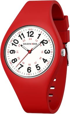

Q. I am a nurse with a nickel allergy. Can anyone supply me with a nickel free watch product that will hold up day after day?
Sandi Adams
- Rockford, Illinois
Watch - Women's Plastic
A. Some of my answer depends on what you want to spend. A gold, not gold plated, watch will not contain nickel. A stainless steel one will. Bulova [affil link] and others make reasonably priced (I got mine on clearance for $15) sport watches which have plastic cases and seem to be likenesses of divers watches with multifunction buttons, etc. If you have a gold plated watch, try to find someone in the jewelry business who can replate it with a nickel substitute (sometimes called white bronze, etc., but not German silver) specifically designed to meet current European requirements for no nickel on jewelry and then they can gold plate.

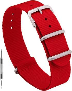

As for watches, I use a Timex [affil link] Expedition with one of their fast-wrap nylon/velcro bands . The band is one-piece and rests between the back of the watch and your wrist, so no metal-skin contact.
With the same watch and a normal band, I get a nice round rash. ;)

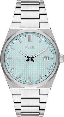

A. All Fossil watches ⇦ on eBay or Amazon [affil link] manufactured after 2001 are made with nickel-free stainless steel. Fossil also makes the Relic brand - sold at Kohls and other department stores - so I assume these are nickel-free as well. They are certainly less expensive than Fossil, and often go on sale. I bought one on Saturday and have worn it every day (today is Wednesday) without any problems. Has anyone else tried the Relic watches?

A. The problem is easily avoided.
Swatch [affil link] make a range of plastic cased watches.
A web search for ceramic watches and straps offers a range from reasonably priced to eye watering expensive.
