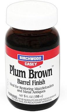

Birchwood-Casey Gun Bluing
birchwood-casey_bluing
Plum Brown Barrel Finish
A. Hi. There is no chemical called nitrate acid, and nitric acid is not part of the gun bluing process. But some nitrate compounds can be one part of the formula for "hot bluing". You can find formulas in the Metal Finishing Guidebook.
Selenium compounds are used for "cold bluing", sometimes called "cold blackening", and they are more of a coating of selenium than a process that actually blues steel. You can read about the differences in our FAQ: Black Oxide and Cold Blackening.
