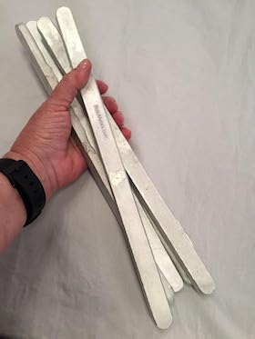

Galvanizing Repair Stick
galvanized_repair_stick
