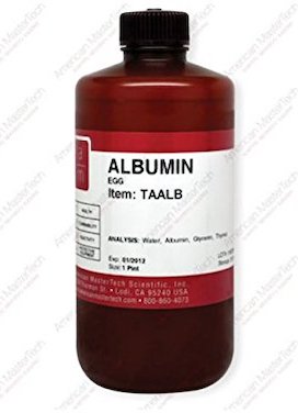

A. Hi cousin Sazlin. The difference between nickel electroforming and nickel electroplating is that nickel electroplating involves depositing nickel onto the surface of a part to improve the part's appearance, corrosion resistance or some other property of the part. The part, which is made of some other material, is the thing of main interest and the nickel is just a coating on it.
In electroforming, the nickel deposit itself becomes the part: a coin, a stamper, a piece of jewelry, a miniature bellows, an intricate machine part, a wave guide, etc.
Egg Albumin
egg_albumin
As with other things in life, there are always borderline cases: is a nickel plated flower or maple leaf a nickel electroform or is it just a nickel-plated leaf or flower -- it can be argued either way.
In practical application though, nickel coatings are usually something like 5-20 microns thick whereas few electroforms could have any structural integrity at that minimal thickness. So electroforming usually involves much thicker/heavier nickel plating, and in turn that may impose some new limitations in how it can be done.
Although I don't quite understand your situation, regarding "just doing nickel laser cut, plain stencil, not full electroform", the removal of an electroform from its mandrel can be a tricky issue because if it comes off too easily it can spontaneously pop off during electroforming, with nickel then growing on the underside and ruining it. We have several threads here about removal of electroforms from permanent mandrels (please search the site), but they usually involve passivating the mandrel with sodium dichromate or egg albumin or something similar as a separation agent, plus paying careful attention to the mandrel design.
