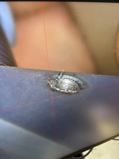

Q. I have a customer who is inspecting backshells with zinc nickel plating under a microscope. I challenge that general visual inspection is more appropriate and closer to the intent of AMS 2417; however, I'm getting challenged. These are W13:P3 backshells with both masked threaded holes and plated thru holes. The issue from the customer is specifically with the threaded holes, screws that stick, and helicoil issues. My customer believes that the plating is causing all their woes and insist that poor masking and poor workmanship is the cause.

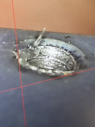

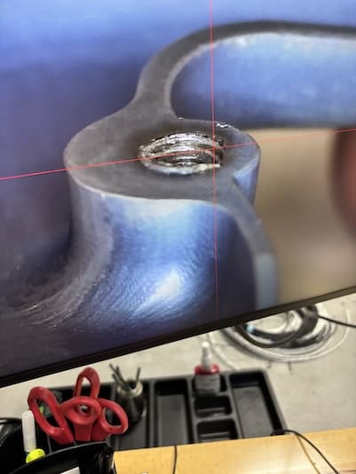

Q. I've attached photos of the backshells in question.
61911-1a   61911-1c
61911-1b   61911-1bDtl
The parts are threaded, sent to a processor for plating, returned, and then we install the helicoils. We think that perhaps the processor is not masking the threaded holes properly. The helicoil fits, but when Production tries to install the jack screw, it gets stuck.
Unfortunately, I am getting several rejections because the receiving inspection "thinks" that the screw will get stuck. They inspect under a microscope and assume the parts are noncompliant.
I want to somehow prove that RI should not be inspecting under 10X magnification; they should just perform a general inspection and send the parts to the floor. I maintain that if there is an issue during installation, it can be rejected then, rather than rejecting on an assumption.

My own quick opinion is that the threading or post-threading mechanical finishing is defective, not the plating. The photos show very obvious burrs that should not be there. If these burrs can be seen by eye they should not have been sent out for plating; if they cannot be seen by the unaided eye, then I would have to disagree with you about forgoing 10X inspection because I don't think parts with burrs like that are satisfactory.
