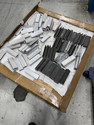

Q. I am plating an aluminum part (Al6101) that is U shaped and also has four peaks (with valleys) on the inside of the U shape. Cleaning and adhesion have not been an issue. Standard clean, etch, deox, zincate (single using CN Bondal). My sulfamate Ni strike and Ag strike are having troubling covering the valleys under the peaks inside the U shape.
I have already setup the Ni as follows; lowered Ni to 8 oz/gal, raised Cl to 8 oz/gal, keep pH 3.8-4.4, raised temp to 135 °F, strike for 2/3 mins @ 15/10 asf.
My Ag strike is 0.5 oz/gal Ag, 16 oz/gal KCN. Strike for 1 min at 5 asf.
Everything covers inside the U shape except a barely visible line that runs just under the peaks. All other parts without extreme LCD are plating fine. Any suggestions?

It might be that you have gone as far as you can with the nickel strike. I would expect better covering power from a complexed cyanide-based solution than from a simple salt like the nickel strike. Have you tried simply skipping the nickel and doing the cyanide silver strike directly on the zincate?
If you can't cyanide silver strike, or cyanide copper strike first, you may need a more complex answer like using an alkaline electroless nickel as the first step, or implementing auxiliary anodes.
If a pic is available (attach in e-mail to [email protected]), it might help.

Q. I did try straight to Ag strike with live entry. The Al started gassing in 5-10 seconds of going in. I tried hitting them with 20 ASF in the strike and 5 ASF. The bondal Zn looks to be a good layer, but I think the Ag cyanide pH is just too high for the Al.
We do have a Cu cyanide strike further down the line. I didn't try it. I don't know why it would act differently than the Ag cyanide.
The customer spec says to use zincate, Ni layer and then the Ag.
If I had another tank space I would try a EN strike. Maybe I replace the Ni sulfamate. The EN strike would be a little slower but even in the lcd!

thumbs up sign While I agree Woods strike has better throw, I have tried to woods strike Al years ago. It never worked, pH is just too low. For the same reason I don't just add HCL to my sulfamate strike. To get a low enough pH to reduce cathode efficiency, it would be too low and attack the zincate/Al faster than it would plate it.
