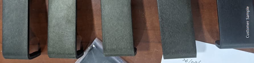

Q. I have a customer part which is requesting for Type 3 Class 2 Anodizing, we are able to meet the thickness of the coat which is 40-60 microns, however after black dyeing I can't seem to match the color of a sample piece given to me by the customer.
61295-1
Details of my process are below.
Part Material : Alu 5083
Dye: Sanodal Deep Black MlW
Dye Concentration: 10g/l
Temp : 55-60
Immersion time 10-20mins
Please advise.
Tommy See
A. Tommy
The pores of Type III anodize are much smaller than those produced with Type II anodize. At a minimum, better rinsing is required.
