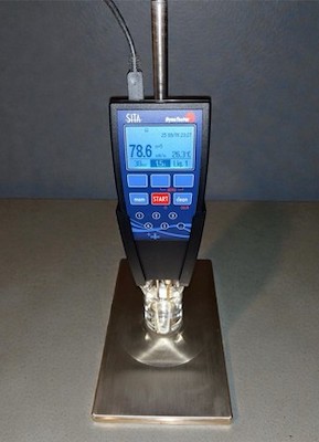

Q. My question is about decorative chrome bath surface tension, as measurements with a stalagometer relate to measurements with a tensiometer.In addition to the Ann Arbor Mi. study, I've done testing on my baths. If anyone else has done this, and has supporting documents could you please let me know. My results show a definite difference, and that the amount of difference relates directly to the amount of metal impurities. Any input would be welcome. Thank you ⇦ Answer?
Layne Hilliard
- Killeen, Texas
Bubble Pressure Tensiometers
tensiometer_bubble
Q. I am having trouble getting accurate surface tension measurements on a chromic acid anodizing bath using a tensiometer. Calibration with a known weight goes fine, but doing surface tension tests on DI water turn out 5-10 dynes/cm low. Results from the anodizing bath also seem low 18-24 dynes/cm. The bath's operational parameters are 26-40 dynes/cm, and stalagmometer readings are consistently in the mid 30's. I am using sterile petri dishes for sample containers, and I am cleaning the tensiometer ring in acetone on eBay or Amazon [affil link] Flammable! with a DI rinse and then flaming the ring with a lighter until red-hot as the tensiometer instructions stipulate. The chromic acid and DI water samples are cooled to room temperature (25 °C). I would normally assume that the stalagmometer is just reading high, but the DI water tensiometer readings are low also, so I think the problem is with the tensiometer.
I read somewhere that tensiometer and stalagmometer readings on the same sample differ by 10-20 dynes/cm (the stalagmometer reading the higher). Has anyone else run into this difference also? Are there any suggestions for normalizing the two readings? Any information would be appreciated.
Chris Start
- Plymouth, Michigan, USA
A. The best info I've seen on the subject is "Report on Observed Differences in Dynes/Centimeter Readings of Various Chromium MACT Method 306B Surface Tension Measuring Devices" by J. Hensley and David York, presented at AESF Week in 1997.
Upshot is that there is a differences, the magnitude of the difference depends upon the surface tension, and the difference changes with solution.

A. Chris,
Not sure of guidelines in your state, but in California the guidelines for each are different.
According to the CA EPA Air Resources Board reference, #93102.8-Chemical Fume Suppressants
"In the performance testing, the hexavalent chromium emission rate of 0.01 milligrams per ampere-hour was achieved under conditions in which the surface tension did not exceed 45 dynes/cm by a stalagmometer or 35 dynes/cm by a tensiometer."
There seems to be 10 dynes difference in the measurement reading. Personally I use a stalagmometer; it's quite simple and little maintenance.
