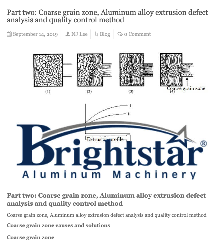

A. This issue is typically seen on extrusions but other manufacturing methods can show these "splotches".
It is known as coarse grain structure, and for extrusions, it is in part the heat treatment of the billet and in part the contaminants that from the shell of the billet that gather in pockets within the extruder and slowly gets dragged out towards the end of the billet.
But heat treatment alone can cause the issue, as it is a type of crystalization in the aluminium that creates these "coarse grains" in it, that can seem almost reflective under light.
The problem is, you cannot see it before surface treatment, and typically it is the etch that brings it out. We've seen a multitude of examples of this over the years and as an anodizer, there is very little we can do about it, as it is in the base material.
Given that these parts are also hard anodized, probably doesn't help either in how clearly you see it after the anodizing.
So, as you said, you didn't send them rings with splotches on them, but sadly that doesn't mean that the aluminium structure was free of coarse grain.
Information ⇨
[M. Stammerjohann provided the links to the two papers shown at right] ⇨
