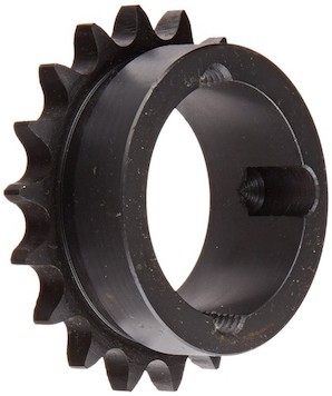

Taperlock Sprocket

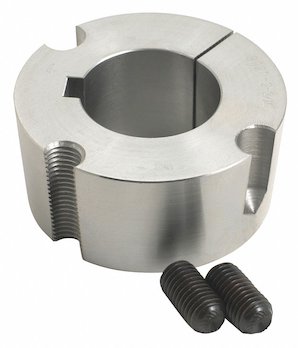

Taperlock Bushing
thumbs up sign Hi Geoff. We are probably having one of those British English vs. American English moments. Split tapered bushings are a way to lock a component like a pulley or sprocket onto a shaft while offering some advantages over boring-to-size and cutting keyways like holding on better and not rolling the keys.
