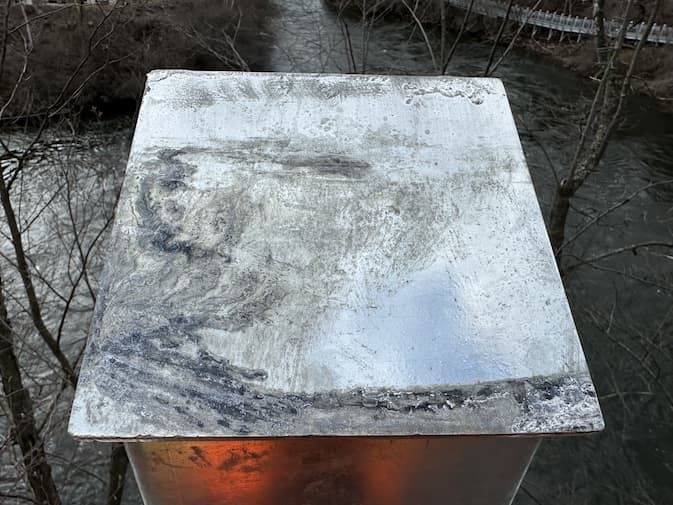

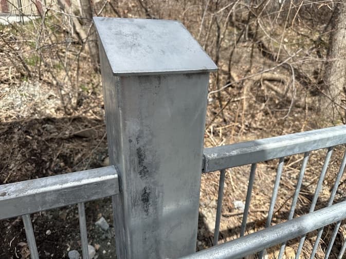

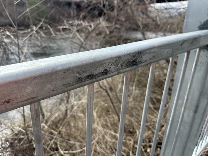

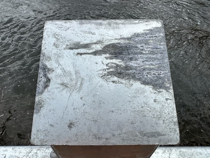

Q. Good evening everyone,
I'm a beginner in the world of HDG. In a recent project, I found the quality of the job, particularly bad. I find embedded foot prints in the finish and a lot of white rust, but my biggest concerns is the dark staining.
56867-15b   56867-15d   56867-15a   56867-15c
My first idea: zinc oxide ashes? I would like to have your opinion about this.
Thanks guys! - Dan

A. Hi Danny,
"You don't need to be a weatherman to know which way the wind blows" -- Bob Dylan
Regardless of what the standards & specifications might say, and regardless of the fact that galvanizing is a functional rather than decorative finish ...
... You don't need to be a weatherman nor galvanizing expert to know that this isn't right. This stuff, in my opinion, should never have been shipped.
thumbs up sign Thanks for your answer. After questioning the site supervisor and reviewing the project history, delivery dates, photographs, and related documentation, it was determined that the components were delivered in January. The pieces were left stored on pallets for several days, during which exposure to snow and rain caused white staining (wet storage stain).
I also suspect that, due to transportation during winter conditions, road spray containing de-icing salts may have contaminated the surface, potentially accelerating the development of wet storage staining.
Danny Perron
Engineer - Quebec, Canada
May 9, 2026
A. This looks like flux staining. Flux is used in the process, a dip in an aqueous solution of ammonium chloride and zinc chloride which then dries in place (normally) before immersion in zinc.
The flux residue floats to the surface of the zinc during steel immersion, combining with ash (Zn Oxide), and this black/grey gunk can get stuck on the steel. It should be wiped off the surface of the zinc by the operators of the process, but they sometimes miss some.
If this residue gets wet later (sometimes as soon as minutes later in the quench or passivation tanks), then it can run producing unsightly marks like these. The high contrast of the staining makes it unsightly.
The standard does not allow flux residues to be left, so this material does not meet ISO1461, ASTM A123, and many equivalent national standards.

A. I think there are several issues here.
1. There are what appear to be bare patches. This might be under-pickling (as Tom Cook says), which could be temperature of acid, (and its not warm yet in Ireland!), but that can be compensated for by longer pickle time in the acid. It's not warm in Scotland either, but we just pickle longer in winter.
This work does not meet the standard ISO 1461 if despatched with bare patches. It is not possible to be definitive from an image, but you could ask to have the thickness measured right on the black spot to see if it is really bare.
The standard does allow for repair of small bare patches by the use of zinc rich paint, but there are limits of size of repair, thickness of it, and the % of the total area that can be repaired.
2. The images indicate that elsewhere the coating is excessively thick. The second image with the "varicose veins" is one indication, and the porosity evident in another image (tiny pinholes even visible) is another example.
The most likely cause of this is the steel chemistry, which is an issue beyond the control of the galvanizer. It sounds like you purchased these, not being either the manufacturer nor the galvanizer. In that case you could ask the manufacturer, or perhaps the vendor for a certificate of conformity to the standard for such galvanizing (ISO 1461) and see what happens. If they refuse, be suspicious.
I think you have good grounds to ask for clarification that this galvanizing meets the standard. As a customer you cannot be expected to know the technical details above, you just want lamp posts that will last for maybe 50 years to first coating maintenance (depends on location and environment how long galvanizing lasts). That's why there are standards. So that the purchaser can have some assurance that why they buy is "right".
Ask for that assurance, and don't take any nonsense for replies.
