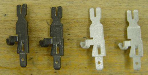

Q. We are into reel to reel plating of stamped parts; of late we are facing Black marks in MSA Matte Tin plated parts with an undercoat of Nickel. This appears over a period of time and in areas where the Tin plating is damaged (scratches).
5694-1 5694-2
The Tin plating thickness is 2 – 4 micrometers. It is prevalent on Brass base material predominantly. Please let us know what could be the possible causes. Thanks in advance.

A. I suspect that your nickel coat is not thick enough to keep the copper in the parent material from migrating up and alloying with the tin.
– Navarre, Florida
