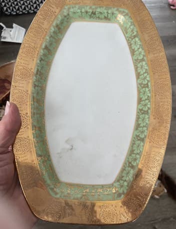

Q. I have a set of Bavarian china trimmed in 22 karat gold and there was a lot of gold on these plates. I have a 10 piece setting with platters and bowls. I want to sell it but I can’t seem to get a price on it, or I’d like to have the gold reclaimed from it.
bavarian china with gold edging
Trying to find out whether anybody can help.

A. Hi Debi. The question of recovering the gold is addressed on this page, but you probably won’t like the answer :-(
There are lots of sites offering ‘instant appraisals’, but they are pay sites, so you might look for similar stuff on eBay or Etsy first to see typical prices and competition. I think trying to sell them is a better answer than trying to recover the gold value.
A. I have processed/recovered gold from china/plates, etc. However you will need a trash can filled with items to get anything back since it’s generally plated in micrograms. The items I acquired came pretty much free. However, as an experiment I purchased gold trimmed items (very Selectively) to the tune of $100. I’ll be doing the procedure to remove, drop and melt. Once completed, I’ll report back. I may even refine twice to ensure .995

Update OK, Sorry for the delay in reporting the final result. One of the largest plates I had, almost fully covered, was not gold! As it turned out I retrieved .6g of tested 22kt. About $30. Not a good return for an amateur. However, if you have a huge pile of them for no cost like I have now, it will be fun to see. As I process larger quantities and make small beads, they eventually will be melted together, refined with inquarting silver and refined to .995 or better.
