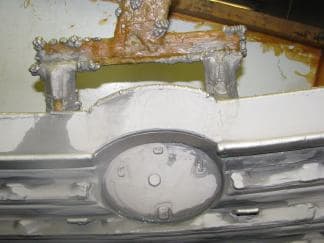

Q. I am currently using a nickel sulfamate tank for electroform plating. I just had a thorough analysis done by MacDermid labs and came back fine on all counts. However, the problem I am having has been ongoing for several years now. I use a silver conductive paint to provide conductivity to plastic and wax forms. I have used this for the last 20 years or so. Until the last several years I have had good success. Now I am finding I am blistering on all projects. Some more than others. When I start the plating at very low voltage and therefore low amperage the blistering is less, but not completely gone. I have tried changing cleaning preparations to no avail. I am wondering if dirty anode bags ⇦ huh? can be the cause of this by increase pull on cathode? Any ideas would be greatly appreciated.

very likely that you have high compressive stress. Try dummy plating at high current density to remove excess stress reducer

A. Michael, if you have changed the cleaners to no avail and McDermid confirms the bath is in spec, the only other things it could be are contamination of the nickel bath - try a Hull Cell ⇦ huh? and see how the nickel comes out on that; I assume you are using the same silver paint that you have been for 20 odd years, so it may be the paint has gone off and is contaminated with something, so try getting a sample of new paint and seeing if it still blisters. If neither of these solve the problem, what other things have changed in your process?.

Compressive stress is usually caused by having too much of a sulfur containing additive in the bath. Usually these additives are ionic and not completely removed by carbon treatment. High current density dummying removes them rapidly since more sulfur plates out at high CD than at low CD.
Another way is to add NaCl or KCl. this will reduce the compressive stress and eventually cause tensile stress.
The dragin from an anodic sulfuric etch most likely contains sulfuric acid and metal ions. Most metal ions and sulphate ions increase the tensile stress and our not removed by high CD dummy plating.

Thank you for your response. After reviewing my last analysis it does show I have tensile stress in the 5,000 range. This shouldn't cause my problem I don't think. Would it be possible for poor contact from rectifier to anode and cathode cause pull away and/or blistering? I am still at a loss.

If you have high tensile stress you should start to see the deposit lifting around the edges. 5000 psi is high but not too high.
Some questions:
How are you measuring stress?
Is the substrate entirely covered with silver or is there also another metal exposed to the nickel solution?
Any chance the silver particles in the paint have separated from the paint base so you have areas of high and low conductivity on the surface?
One of my clients makes electrical contact in multiple places to the substrate. if one of the contacts has high resistance the silver actually gets etched away near that contact. Is this possibly what is happening?
Can you post a photo of the part.

Q. I put a job in this morning at 44 asf. Job was about 6 sq feet. After 15 minute check, it looked great. After another 15 minute check it blistered all over the place. Help.

When you took your work out of the tank to examine it, you broke the circuit and the nickel will have passivated, especially if it is bright nickel. Any subsequent coating will not adhere to the first deposit and will blister. Repeat your test for 30 minutes but do not take it out after 15 minutes to check it.
Q. I haven't carbon-treated my tank since 2003, nor carbon filtered it. Also, I haven't run and LCD Dummy more than a few hours since that time. Would excessive metal and organic contamination cause this kind of blistering. Also getting cracking. Any comments would be greatly appreciated. Thanks!

My LCD dummy plate is covered with a dark shiny plate at about 3 asf. My last analysis showed no copper or iron contamination, what about silver contamination from the paint?
