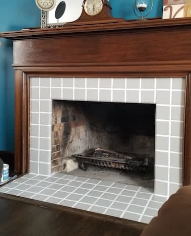

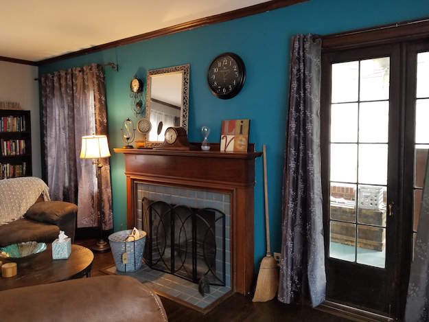

Q. Hi. I have painted the tile on our working, wood-burning fireplace. The tile does not get very hot when the fireplace is in use. However, I cleaned the tile well, let dry for two days, did two coats of primer and then two coats of our paint color for the tiles. My plan was to topcoat the latex interior paint I used with three coats of clear heat resistant poly. Will this be sufficient to keep the paint from bubbling up when in use.
- DANVILLE, Illinois USA
September 3, 2019
A. Hi Tammy. Your work sounds good, and the paint shouldn't bubble unless the ceramic tile has such a high glaze or so much wax that even primer won't stick. The clear poly will not reduce the tendency to bubble, but will make it easier to wash away any soot. Let us know how it works out ... experience trumps book knowledge :-)
