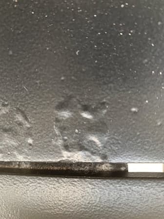

White spots and blistering of powder coated furniture
Q. Recently powder coated aluminum patio furniture for a restaurant. Developing white spots everywhere, and some obvious blistering with white powdery underneath.
50530-1f 50530-1e 50530-1b 50530-1d 50530-1c 50530-1a
Coater says its something environmental or how we are cleaning it, and nothing to do with the powder coating or the aluminum underneath.
Doug Drukker
Construction Director - Columbus, Ohio USA
July 7, 2019
A. Hi Doug. It's certainly obvious that the underlying aluminum is corroding terribly, but unfortunately it is difficult to know why :-(
While it is possible that the pretreatment and powder coating are grossly defective, it also sounds possible that, in a restaurant setting, maintenance workers are repetitively using strong bleach or other cleaners and powder coatings are not impermeable so the aluminum is being attacked.
A. Hi Doug,
I will say Ted is right, the aluminium is badly corroding, what kind of pretreatment is used? and what kind of powder? on the Pictures it looks like the layer of powder may be too thin, also if you may have used some pretreatment not meant for aluminum, this could happen.
