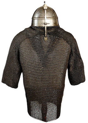

Galvanized chain maille rubs off black on skin and clothes
Q. I am currently making a chainmaille hauberk for a friend of mine, and using 16g galvanized wire to turn the rings. I have noticed significant black "rub-off" when working with these rings, and I am wondering if anyone knows how I can get rid of this so that the hauberk will not stain clothing/skin when worn.

A. More info please....
Is this a mark or stain that rubs off the galvanizing?
Sounds unusual. Its common to get a white mark rubbing off, thats zinc oxide, zinc carbonate, mixture, and these oxides are unavoidable.
Black "rub off" might perhaps be dirt?

Q. When I put on the hauberk to test for size, it leaves a black "stain" on clothing and skin. It will wash off of skin, but it is harder to get out of light-colored clothing. I have washed the rings with soap and water, and I tried a white vinegar ⇦ in bulk on eBay or Amazon [affil link] bath that someone recommended, but nothing stops the staining. Also, you could say that the staining is more "grey" than "black"

A. You can coat it with some good metal lacquer,before that you can clean it with neutral solution of ammonium citrate(5% pH 7).Hope it helps and good luck!
A. I wonder if this staining is from the natural acids and oils that seem to be present on the skin and hair, and which form zinc products which then rub off and stain.
There probably isn't an easy solution for this one, maybe even means the wrong protective coating for the job.
I've seen this type of chain maille in uncoated steel before. Yes it will go rusty brown if wet, but if worn regularly and lightly oiled seems ok.
If you wanted to strip off the galvanizing, you could do this with dilute (say 5%) acid. Hydrochloric, sulfuric, even acetic. (If you're not familiar with using acids, get someone who is experienced to do it.)
