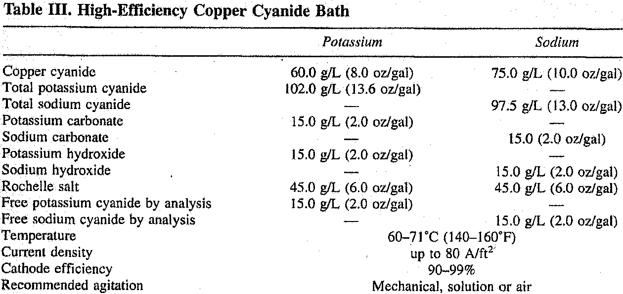

Q. We operate a copper cyanide plating bath here.
It consists of Copper Cyanide, Rochelle Salts on eBay or Amazon [affil link] , "free Sodium Cyanide", and Sodium carbonate.
It doesn't appear to be made up to any particular specification.
Can anyone recommend a typical bath makeup, giving a range of component concentrations?
Does this conform to any particular spec?
The copper plate is used as a mask for heat treatment of steel parts.

A. For high speed, the high efficiency bath is best.
(Metal Finishing Guidebook, 1998 edition, page 232)
47113-1
Usually available on eBay; sometimes on AbeBooks or Amazon
(affil links) mfg_online
But I would just start with whichever printed formulation from the Electroplating Engineering Handbook ⇦ this on eBay, AbeBooks, or Amazon [affil link] or the Metal Finishing Guidebook
your current analysis is closest to, Mike. That should get you to an accepted, workable, solution quickest, easiest, & cheapest.
An additional reason why this might be the best approach is a strike is probably not enough thickness, but a high efficiency plating bath requires that a strike precede it. So the middle of the road strike/plating baths with midrange values are probably the best compromise for a one-step process.
