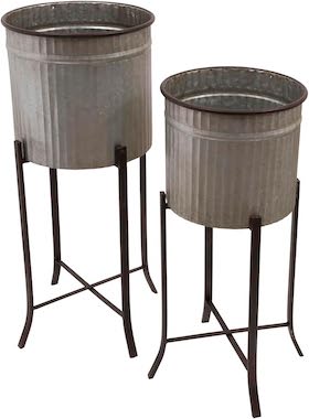

Q. I bought some large galvanized planters with no drainage holes (for indoor or outdoor use). Since they are square, I am having a hard time finding liners that allow me to maximize the space. I would like to plant some herbs and small tomato plants in them. If I drill holes in the bottom and plant directly in the steel, would the planters be considered food safe for planting?

Q. I'd like to grow an herb garden outside my kitchen door. Crate and Barrel has a "Wide-rimmed planter in lightweight, zinc-finished galvanized steel" with an over-the-railing plant holder that fits over my aluminum railing - very convenient to run out the back door and grab what I need while cooking. And the plants wouldn't take up space on the very tiny patio.
Is there any reason to think that this zinc-finish on galvanized steel could leach toxins into the soil, and then into the herbs? The planter is made in Vietnam. I am somewhat leery of the safety of food related items imported from China or outside the US. If there is the slightest chance of toxicity, I won't use it.
Mary McShane
gardener - Westfield, New Jersey, USA
May 7, 2012
Galvanized Planter
galvanized_planter
A. Hi Mary.
We appended your inquiry to a similar thread which should help reassure you. On top of that, your planter is sold as a planter, i.e., it is designed for the purpose, which should offer some extra amount of assurance compared to using something that wasn't designed for the purpose.
But with cadmium in children's jewelry sold in Wal-Mart, lead in the paint of kids' drinking glasses given away at McDonalds, antifreeze in the dog food ... requiring "not the slightest chance of toxicity" is asking a lot. But I think we can very safely say that growing your own herbs & spices in that planter will be much safer than using imported herbs :-)

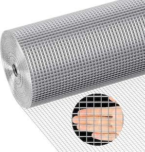

Q. Hi! I am planning on using galvanized mesh cloth to line my raised beds. It is steel galvanized post-weld.
Should I be concerned at all about metals leeching into my soil over time? I understand that acidic soil may leach the zinc. Would it be able to leach toxic levels? And I'm worried that the weld is lead based. Is that a possibility? And if so, does the galvanization process seal it in? Would I need to be worried about lead leaching over time as the galvanization degrades?
Or I guess, what would be your suggestion of what to look for in gardening mesh that will be underground to control gophers in a veggie garden.
Thank you!
Jenny Ladd
- Atlanta, Georgia USA
April 10, 2018
Stainless Steel Hardware Cloth
hardware_cloth_sst
A. Hi Jenny. I don't really understand your question about lead-based welds. To my knowledge steel is welded with steel welding rod.
What I would look for is any product designed for the purpose. The chance of you being harmed by it then is quite small; it's when we re-use things that were designed for other purposes that we must worry about what they might be made of. But even galvanized wire cloth may not last more than a few seasons underground. If you consider stainless steel mesh affordable it's a better idea
