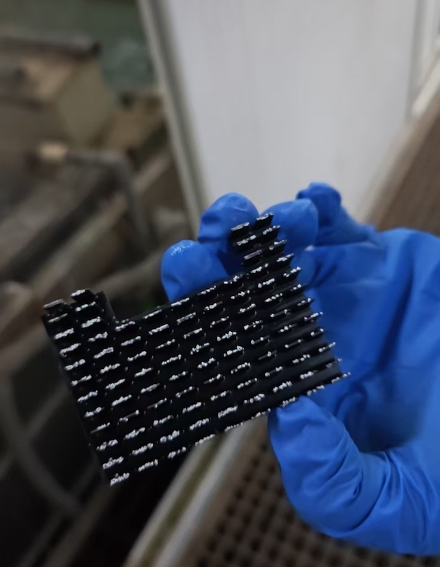

Q. After dyeing of anodized aluminum followed by nickel acetate sealing, snowflake-like white powder accumulates at the sharp edges and corners of aluminum parts. Testing shows the main components are nickel and oxygen. Is this similar to what you have encountered? What are the common causes of this issue, and how can it be solved in mass production? ⇦ Answer?

Ed. note: Are your components also castings like Patrick's, Liu, or something else?
Q. 6063 extruded aluminum - Snow-like white ash deposition and corrosion only appear on the workpiece after hanging on the rack for sealing; no abnormal issues occur without rack hanging.
44945-2
Can this problem generally be improved by adjusting the pH value or formula of the sealing bath solution?

A. Aluminum How-To lists about 30 different causes for "white spots" and smut. By far the most frequent is calcium salts left behind from the seal, which you see only after the water evaporates. The second most frequent cause is galvanic corrosion usually between titanium racks and stainless tanks/heaters. Come back to us with more information on the racking, tank materials and whether or not the dye and seal are made up with deionized water and whether tap water is dragged into the dye and seal. This problem CAN be beat.
