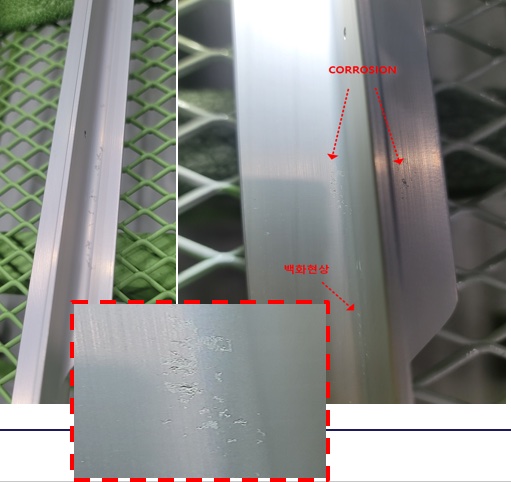

Q. I performed Boric-Sulfuric Acid Anodizing (BSAA) on extruded aluminum parts, and after the anodizing and sealing process I found several surface defects, as shown in the attached photos. The issues include:
• White staining / chalky residue
• Rough, uneven surface areas
• Small pits or spots that resemble localized corrosion
• Non-uniform anodic film formation
• These defects appeared only after the BSAA process, not on the raw extruded surface.
41155-2a
Since this is an extrusion product, I'm also wondering whether extrusion-related factors—such as die lines, surface contamination, or uneven microstructure—could contribute to this problem.
I am trying to determine whether this is:
Actual corrosion occurring during/after anodizing,
A result of incomplete cleaning or degreasing,
Over-etching or insufficient desmut,
Poor rinsing or DI water quality issues,
Improper sealing conditions (temperature, pH, or time),
Or an interaction between BSAA and extrusion surface characteristics.
If anyone has seen similar white stains or pitting specifically on extruded aluminum after BSAA, I would greatly appreciate your insight on the root cause and how to prevent this in future runs.

First we were running only half of the part, and we observed big pits and we supposed the pitting was before anodizing.
After that the other end was run and when the panel was removed we looked the first half full of big pits and the second one clean of them.
Running conditions.
First running: 18 volts, 20 min ramping 5 v each min starting at 0 v
Second running; 18 volts, 20 min ramping 5 v per min starting at 5 v and higher air agitation ⇦ huh? ⇦ Answer?
