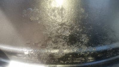

Did plating shop corrode my wheels?
My alloys were originally chrome and then repainted over the chrome a few years ago.
After some time the chrome has started coming off in strips along with the paint.
Took one of my alloys to a shop that put it in acid to strip and tried to re powder coat.
When collecting the wheel from the shop I noticed what looks like a lot of corrosion on the inside of the rim some of which is fairly deep.
Can someone advise on what could have caused this as the shop is stating that the corrosion was already there.
Have checked the other rear wheel and it doesn't have any major corrosion on the inside. there was a lot of white residue all over the outside where the chrome was just lifting off.
Any help would be much appreciated.
Kind Regards,
- Glasgow, East Kilbride, United Kingdom
June 2, 2017

A. Hi Gary
Road wheels operate in some of the most aggressive environments that surfaces are expected to face.
Your question has two clues. East Kilbride has harsh winters with lots of salt on the roads and you say the wheels were re-painted some years ago. Old alloy wheels corrode! That is why there are so many companies specialising in re-finishing them.
Chrome plating on alloys can set up corrosion problems and painting on top makes the situation worse.
Your best bet is probably to get them polished.
