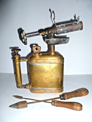

Avoid epoxy adhesive if you want a reliable bond. Copper reacts with epoxy (or more correctly the hardener). Brass and copper can be epoxy bonded but need to be tin plated first.
The best "glue" for copper is solder. You need 60/40 Tin Lead solder sold for electronic work with a non corrosive flux core. It is common and cheap. It comes as a wire and you may need to flatten it slightly by rolling or gentle hammering - it is quite soft. Get your cents direct from the bank and handle them by the edges and you will probably not have to clean them. Cut (small) pieces of the solder wire and assemble the stack. Place in an oven at about 190 - 200 °C (the solder melts at about 185 °C) To separate the stack or to make other shapes, a small hobby blowlamp works fine.
PS. Don't get paranoid about the lead in the solder. It produces no measurable fumes below 400 °C Any fume is from the flux -- don't go sniffing it!
