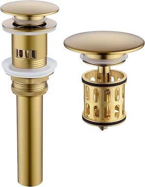

A. Hi, Noel. When you say "outlet" you're probably referring to the drain fitting in the bottom of the basin? If so, and if it's not really something special, I think you'll save money and time by simply replacing it. This is an easily replaceable part made of a thin gauge of brass.
As for cleaning it, if brass polishes don't work, vinegar
⇦ in bulk on
Amazon [affil link] + salt + flour probably will, but may leave it very orange colored, which can be corrected with a few applications of a commercial brass polish.
The thing is, brass doesn't stay bright: it tarnishes very quickly. If it was ever bright it was because it had lacquer or a clearcoat on it. Good luck.
