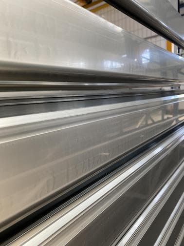

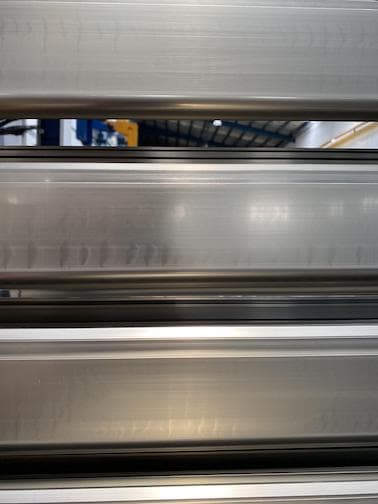

Q. Lines appear on aluminium profiles
Dear Sirs
We have an aluminum profile production and anodizing line.
Recently, a problem has arisen in the profiles, which is more visible and determined after anodizing. (as you see in the pictures)
37711-2a   37711-2b   37711-2c   37711-2d   37711-2e
Could you please help and tell us what could be the cause ?
Yours Sincerely
Mousavi
Hadi Mousavi
- Istanbul istanbul
A. I recently managed a high production anodize line that had a very similar problem that was resulting in a reject rate of almost 40% of our production. We spent a small fortune trying to get the the root cause of the defect. We could never nail it down for certain within the time that I worked there. We investigated the extrusion dies, the lubricant used in the extrusion process, machining oil used during forming and hole-drilling operations, the buffing wheels, the compound that we used on the buffing wheel, the pressures and speed settings on the automated buffing machine. All of those were potential causes. The only thing that we able to eliminate for certain is that the issue was not created during any phase of the anodize process (it is only revealed as a result of the process as you had said). The problem definitely originates prior to anodizing even though it may be invisible on the pre-anodized part. That was my experience anyway.

A. Can you give us more details about this problem such as whats the defect rate/ happens only on these profiles/happens only etched profiles or polished profiles?
Frankly, as if it had remained water stains due to insufficient rinse and neutralization before anodizing process.if I am not wrong, It seems caustic etched profiles. So you should keep cleaner rinse bath and use more effective chemical for neutralization bath or increase concentration of neutralization bath (also you can add nitric acid if you don't use).
Alaattin Tuna

thumbs up sign Jon,
Actually I agree with you. It happens before anodizing but still were unable to find the cause .
Thanks for your reply
Alaattin,
Actually It happens before anodizing and gets visible after it.
We couldn't find the root problem.
Hadi Mousavi [returning]
- istanbul
A. Hadi, please respond to the questions which I asked you (also other contributors). You won't solve your problem if you don't. Thanks.
