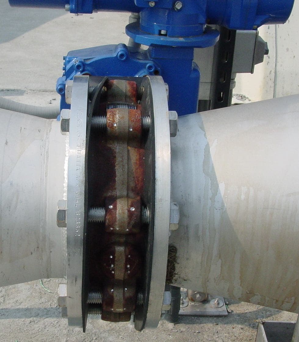

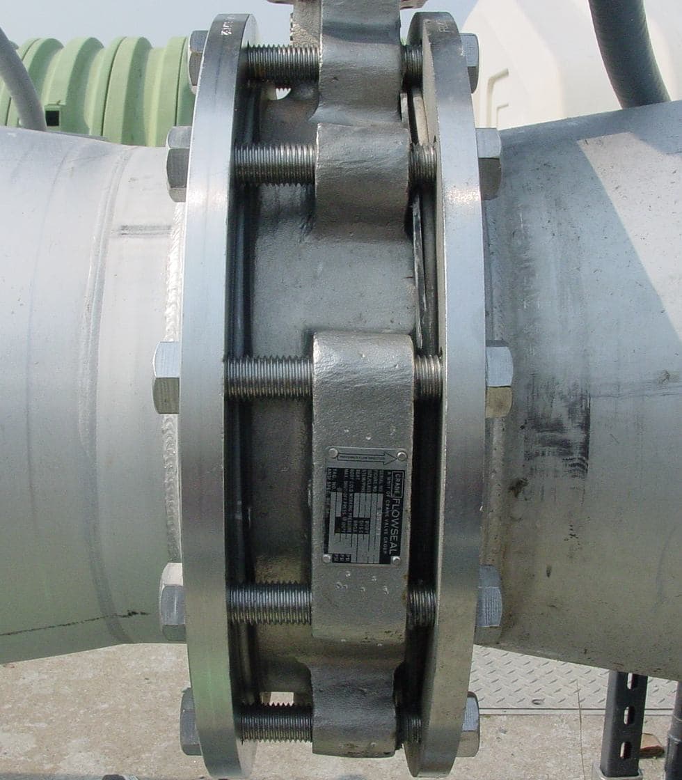

Q. We in our water department encounter a new problem with a stainless steel butterfly valve used in the process air line. All valves 10 ” and less 316 SS Valves are corroding and valves 12″ and above are not corroding and also all the corroded valves are not attracting the magnet and others not. SS valves are not suppose to attract magnet.These valves are cast based on “CF8M” process. Can anyone help me why these 316 SS(CF8M) valves are corroding? Other valves are attracting the magnet why?

A. CF8M is the casting alloy that corresponds to the wrought 316 material. It has slightly different chemical composition, which has several consequences.
1. Foundries usually balance the relative amounts of the various elements (while maintaining each within its own specified range) so that the microstructure is predominantly austenitic, but with typically 5-8 percent ferrite. The ferrite phase is attracted to a magnet (if it is present to say 5% of the structure, the strength of the attraction will be in the vicinity of 5% of that of mild steel). It is by no means essential to induce this small amount of ferrite, and indeed the CF8M composition can be balanced so that there is no ferrite and hence no magnetic attraction, but knowledgeable foundries do not do this unless these is a special need for low magnetic permeability that was specified by the purchaser. The wrought 316 has its composition deliberately balanced so that ferrite does not form, because it is much easier to roll the material into its final form (plate or strip) if there is no ferrite in the microstructure.
2. A consequence of the ferrite is an increase in strength during and immediately after solidification, which greatly reduces the possibility of hot-tear defects occurring which would require subsequent repair by the foundry – such a repair would not detract from the integrity of the component, but is an avoidable additional manufacturing cost. So the ferrite is induced to give this protection against hot tearing.
3. An incidental benefit is that the room temperature yield strength is increased, although this benefit is rarely exploited by design engineers.
4. An incidental benefit is enhanced corrosion resistance, because the chromium specification range for CF8M is higher than that for 316, and furthermore it is usual to manufacture CF8M towards the top end of its chromium range as part of the ferrite-inducing element balance but to manufacture 316 towards the bottom end of its chromium range as part of the ferrite-avoiding element balance. The higher chromium content of CF8M confers better corrosion resistance.
5. All of the above relies on the manufacturer heat treating the product appropriately, so as to avoid the presence of any of carbides, or sigma phase, or chi phase, in the microstructure because any of these will detract from corrosion resistance.
Additional note: Having written the above, it now occurs to me that perhaps you are referring only to rust on visible external surfaces of the valves, and not to corrosion on internal surfaces. If that is the case, it is possible that a manufacturer shot-blasted the castings with steel shot rather than stainless shot, thus contaminating the surface with non-stainless debris. There are many postings on this site that refer to pickling (or passivation) to clean such contamination from stainless surfaces.
You need to talk with the suppliers of the valves to clarify their manufacturing procedures. Bear in mind that any one particular valve supplier might source his component castings from different foundries, so even if you are only using one valve supplier you might have castings from several different manufacturers, and some might be using better procedures than others.

Q. It is true that the rust is visible only on the visible external surface. Is it common? Can you please explain me the difference between steel shot blasted and stainless shot blasted? And how does this affect surface rusting as shown in the picture?

A. Aha! It becomes clearer. When your original query downloaded, only the first of what I now know to be two photographs appeared on my monitor. Some glitch in the web site or my browser, I guess. So I saw no rust on the outside of the valve. But now, two photographs download and the second one makes it clear that many of the points I made in my original response, while correct, don’t apply to your case.
During heat treatment of stainless steels, a thin layer of oxide is formed on the surface because the heat treatment temperature is close to 1100 degrees C (2000 degrees F) and most often in a mildly oxidising atmosphere.
To remove the film of scale, the castings are blasted with particles of an abrasive. Very fine particles of the abrasive (dust, if you like) get stuck in the surface of the stainless steel simply because they are small, hard, angular, and hit the relatively soft stainless steel surface very fast. This is very much a surface phenomenon – we are talking particles a fraction of a millimeter in size, embedded a fraction of a millimeter into the surface
If plain steel or iron particles are used as the abrasive, these embedded particles will subsequently rust when exposed to air and water in the same way that any plain steel or iron rusts. By electrolytic action, the rusting dust particles will also corrode the stainless steel near them, so an individual particle creates a speck of rust that is a bit bigger than the original size of the particle.
If suitable stainless steel particles are used as the abrasive, the above rusting reaction may not occur at all, or may occur to a much reduced extent. This depends in what grade of stainless steel is being blasted, and what grade is being used to do the blasting. If there is a substantial difference between the grades, there can still be subsequent corrosion.
The most suitable abrasive for blasting stainless steel is garnet. Being nonmetallic and non-electrically-conductive, any garnet dust embedded into the surface will remain inert. With stainless steels for more severe applications – that is stainless steels with much higher corrosion resistance than the ordinary 316/CF8M class – the use of garnet is virtually mandatory, as matching stainless abrasive particles would be more expensive to manufacture and sell than is the garnet abrasive.
But if plain steel or iron is used, the embedded corrosion-prone dust can subsequently be removed by a pickling process, basically washing the surface with nitric acid or a mixture of acids including nitric acid, which dissolves the metallic dust particles without damaging the stainless steel.
For more information on this process, search the archives of this site on “pickling” or “passivation”.
But given that the components are installed in service, if you want to clean them up then a treatment involving nitric acid is not appropriate, as there may be adjacent components that would be damaged and the run-off could be a bit nasty. A supporter of this site advocates an alternative process using citric acid. I don’t know if that would be effective in your case, now that the rust has formed. Probably,the proponent of the citric acid process will read this thread, and respond.

Ed. note: Sorry, Bill, we originally displayed the pictures with the good one on the left. I think readers didn’t realize that there was another picture off to the right, out of the field of view on some screens.

If you are grit blasting with steel shot you will DEFINITELY have a problem with corrosion. You are embedding iron into the surface if you do. This will rust. You must use non-ferritic grit for blasting, and even then do it with care.
You also need to passivate afterwards, regardless of the process, to get assurance that you will not have corrosion. We have great success in getting corrosion resistance of CF8M castings.
The parts can be cleaned easily in situ, even after corrosion; but if the pitting is too bad it will be a maintenance headache.

Regarding the rust on outside of 316 castings, This can be caused from blasting with steel shot. Where the steel becomes embedded in surface. If no further machining is done, then this embedded iron will rust over time. For internal surfaces which are most likely machined after casting + blast cleaning, the embedded iron would be removed.
There are stainless steel shots and stainless steel cut wire shots available, which will prevent embedding of Free iron in the first place. The next time a unit rusting in the field is removed, have it sectioned + evaluated metallurgically for the depth of rust, and give you peace of mind for other units in service are ok. You will then be able to confirm if rust is limited to as cast surfaces.

A. My final post on this thread.
In general terms:
Pickling is only needed if the castings are blasted with steel or iron abrasive, thus contaminating the surface. If they are blasted with stainless shot or garnet, there is no need to pickle them afterwards but no harm is done if in fact they are pickled.
For your castings:
If they are NOT rusting, either (1) they were blasted with an appropriate abrasive and might or might not have subsequently been pickled, or (2) they were blasted with an inappropriate abrasive and were subsequently correctly pickled. It doesn’t matter which, because they’re not rusting and that’s what you want.
If they ARE rusting, there are multiple possible causes, including (but not limited to) any one of, or combination of: inappropriate abrasive and subsequent pickling, inappropriate element balance within specification, incorrect heat treatment, composition out-of-specification, unsuitable specification in the first place. Examination by a metallurgical laboratory would be needed to determine the actual cause(s) in a particular case. I’d give you a price myself to do the investigation, but you’re in USA and I’m in Australia so it really wouldn’t work.
