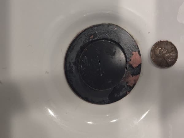

Q. I left a cleaner in the sinks too long and the oil rubbed bronze finish stripped away, is there a way to fix this that doesn't require replacing the parts?
36585-1a   36585-1b
Sarah Walker
- El Cajon, CA
April 28, 2026
A. Hi Sarah,
I believe that you can brown up the salmon color so it doesn't catch the eye with any brass darkening solution, including the Birchwood stuff listed below. After you've darkened it, any clearcoat, like brass lacquer, or even clear nail polish, will help prolong its life.
