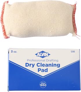

Pounce Pad
I'm interested in the same question. I think the issue is the clear would have nothing to bite onto. Maybe there is some kind of clear adhesion promoter that would work?

A. Hi. I haven't actually done this; I'm just talking, but:
I think I'd try to sand near the edges to taper them a bit to minimize that "corner catching". Then I'd rub the mylar down with pounce powder ⇨
(this is what draftsmen do to help get ink to stick to it).
Follow that with a clear adhesion promoter ⇨
then finish with your automotive clear coat. Good luck.
