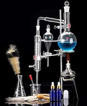

How would distilled water be produced for routine work in the laboratory?
Ugwu jenny
- UDI.ENUGU STATE NIGERIA
August 9, 2012
Distillation Starter Kit
distillation_kit
August 10, 2012
Hi Jenny.
You can get a kit for learning how it's done.
or a packaged distillation unit of almost any size. Good luck.
