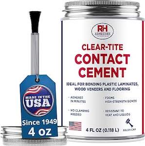

Q. I have a wood table with a copper overlay I purchased it in Bali. The copper is lifting up. What...?.. and how can I fix this issue

Contact Cement
contact_cement
A. Hi Sharon! Without photos and a lot of background it's hard to say why this happened or to be totally sure of what you are describing. But perhaps the best adhesive for a surface like this that is lifting up, but is partially in place so there is no "repositioning" problem is "contact cement" because gluing both sides as is done with that allows you to let both sides partially dry, then instantly lock in place the second you push the copper back down.
