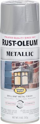

Q. I am interested in painting the metal frame that surrounds the glass in an existing (prefab) shower stall. The metal is now "gold" colored & does not match the room's decor. My idea is to paint only the outside (not the metal on the inside of the shower stall) using a silver metallic rustoleum paint. What would I need to do to make sure the paint adheres to the surface?

Marj: It's possible that a "gold" colored frame is brass if it was very expensive. If it wasn't outlandishly expensive it is probably anodized aluminum. Mark's advice sounds good to me, except that I think the first layer of paint should be a self-etching primer
Regular paints will not stick to brass at all, and may not stick well to aluminum. So it's best to use a primer that will cut through any oxidation and get down to the metal.
Jesper: I don't have personal experience with it, but if properly primed and with a good finish paint, it should be fine.
Cassandra: The toughest paint for interior showers is probably, ironically, exterior paint. Paint that would be sold with pictures of patio or lawn furniture would probably be ideal
Fran: Marj. probably answered your question with her question. Silver metallic rustoleum paint may be what you need.
Mark: Thanks as usual for your great help on these questions.
I think the response to rough it up and tape it off and then spray with rustoleum is probably doable, I found a similar response. thanks!

Self-etching Primer Spray
self_etching_primer_spray
Hammer finish "Outdoor" Paint
Rust-Oleum Silver
