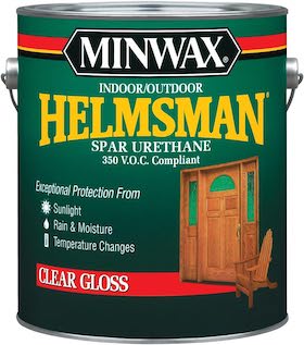

A. You can buy UV inhibited polyurethane, but it is not clear! It is for exterior work and is a sick honey color right out of the can.
Polyurethane for Outdoors
polyurethane_outdoor

Q. I am looking for recommendations for an exterior clear urethane finish for a sign. I used a Minwax water-based product on a wood table and the sun burned it off in a year. Thanks.
