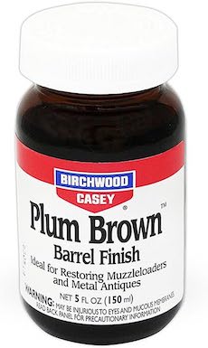

Plum Brown Barrel Finish
The best "aging" method that would be true to the period (18th century) AND easy to do, would be go to a Gun Shop which handles Black Powder/Muzzleloading firearms and purchase a small bottle of Birchwood Casey's "Old Time Browning" [adv: Plum Brown on eBay or Amazon [affil link] . Then you remove the barrel and lock, get outside or in a well-ventilated area, and slowly heat the barrel with a propane torch, moving the flame evenly over the entire barrel until it is well heated. You apply the browning copiously, being sure to avoid the fumes. Be careful when you heat the lockplate face; you don't want to anneal (soften) the frizzen, internal springs or other parts. When the barrel and lock have cooled, carefully remove any excess caking of browning solution with #0000 steel wool ⇦ on eBay or Amazon [affil link] . Remove as little as possible, just the caked-up stuff. If you're a "natural" you won't have any caking; but that would be unusual. Brass can be aged by using a fine emery cloth to produce some fine etching on the surface (use cloth in circles, not in one direction), then applying a salt water solution with Q-tips ⇦ on eBay or Amazon [affil link] or fine paint brush. Wait a few days; wipe off the salty residue. If you don't have a good enough patina, try lemon juice. Be careful to wipe away any saline or lemon juice from the stock.
