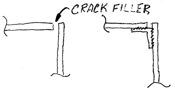

Q. What to use to seal a galvanized fishing boat live well? 3 0f 4 edges are open on the bottom of the live well. poorly designed.
I have used JB weld and a few others over the years buy they all let loose after a year or two I believe with temperature changes, etc.
I tried low heat welding once but it started to burn the carpet on the outside of tank.
frustrated.
Jeff Schneidewend
- Hortonville Wisconsin usa
March 24, 2020
Epoxy
A. Hi Jeff. If the epoxy is being used as a crack filler, yes a crack filler is going to give out pretty quickly.
28857-1
But if you can make little angle irons out of sheet metal and epoxy them in place I think the repair will last.
