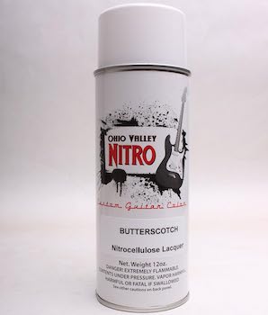

Q. I have been making exotic wood pens for about 2 years. I have tried several wax and polish finishes. They start out nice but with use they quickly dull. I read about "nitrocellulose lacquer" as a finish for pens. Would you recommend this for pens? If so, where can I find it, and how do you apply it.

A. Nitrocellulose resins are very old and not very good over prolonged times. Furthermore, they can be explosive. Why not consider acrylic varnishes, which are much more stable and safer.
