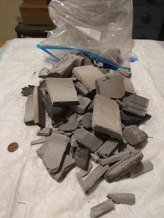

Q. Hello. My uncle had a garage for repairing cars. He recently passed away, leaving behind a half of a 5 gallon bucket of platinum dust from all the catalytic converters he had dealt with over many years as well as 3 actual converters. We , meaning my aunt and myself have no idea what to do with it. Of course we want to sell it but where? To whom?
A. AguilarFamily - Jacksonville North Carolina
August 1, 2024
A. Hello A.
I feel for you and your aunt, and hope you can figure it out, but you may not be able to.
As I sit here tonight, my cell phone is next to me, ready to bring up my front door camera with a view of my car ... because catalytic converters have been cut out recently within a few doors of me as well as on several other streets in town just this week, and the police are asking everyone to watch for such activity.
You obviously will be unable to document the provenance of the honeycombs and the bucket of dust, so it probably just isn't worth it to recovery facilities to get involved. I wish you luck, but I don't think it's going to work.
