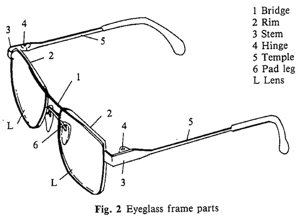

A. I think there is a problem with terminology-- frames for eyeglasses are brazed not soldered, since the temperature exceeds 450 °C. nr
Titanium in the presence of any oxygen forms a tightly adherent oxide layer, which impairs joining by brazing, welding, etc. Therefore, titanium is brazed in an argon atmosphere, without a flux, using different types of filler metal.
