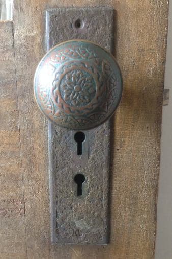

Q. Greetings,
I have a similar situation. I am attempting to restore some old door hardware, doorknob, mortise lock, knocker, and mail-slot. I am having a hard time determining if the original hardware is Antique Copper, Japanned, or filthy.
Can anyone shed any light before I go trying to restore grime or polish off gilding or anything?

A. Gabriel,
Easiest way I know to find out is to take them off the door and look at the inside/backside of em. This should provide the majority of the information you need regarding them being plated, solid, or whatever.
The other bonus is that you can also find a couple out of the way spots that won't show that you can test any cleaning methods on that won't show.
Marc Banks
Blacksmith - Lenoir, North Carolina USA
A. As the one respondent mentioned, In the period in which this finish was used it was called "Antique Copper". In our own time it is commonly called "Japan" or "Japanned". I don't know why, but this has lead to confusion. Japan Finish is a black lacquer, sometimes asphalatum varnish, and was a very popular 19th/early 20th century finish on metal (including on,apparently, automobiles), and was usually a gloss finish originally. Common into the 1920s. https://en.wikipedia.org/wiki/Japan_black
