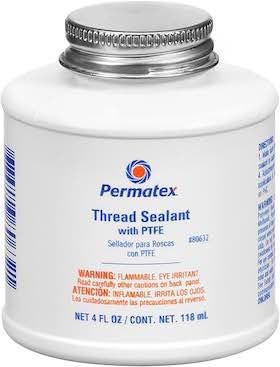

Teflon thread sealant
A. That was a good response, but I would recommend liquid teflon sealer rather than teflon tape. The tape is good for metal joints, but the liquid (paste) sealer is better on plastic. Follow the instructions, FILLING only the first two threads.
