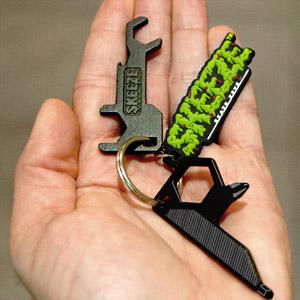

Q. Hey Guys, great forum. I single-handedly launched a skateboard tool start-up in January.
The tools are made of tempered carbon steel, and I initially was having them finished in hot black oxide in the Midwest.
The factory that makes the keys can make them black with e-coating instead which I may do. But we are going to add an autograph of a pro skater on the side of the key as if written in a white or greyish/silver paint pen. I assume a laser is what we need. In this case, do I need a fiber laser that would remove the black e-coating to reveal the silver raw metal underneath so it has the desired look?
And second, we also want to do a version that looks like a gold key. The factory said to e-coat the key in gold I'd have to order about a million to be cost effective (not gonna happen). Powder coating seems out due to thickness, and I am gravitating towards plating.
Maybe an alloy of gold and zinc or brass so it has the look at a budget price? What do you recommend and then if we want a BLACK autograph on these gold keys done with a laser, is this going to be possible and does it require a fiber laser?
The last scenario may be a pink key with a white autograph, which may have to be paint or powdercoating with a white fiber laser. I'm in over my head but you can imagine the durability needs (needs to last but eventually any amazing coloration method would be toast).
The users of these tools would not use them super frequently so if in a year they are a little beat up it would be expected. There is a metal file on the tool and a saw and it's a given that any color on these would be toast after even one or two uses on the 'grip-tape' and I see no way around that, and it's acceptable.
Thanks so much for the assistance!
